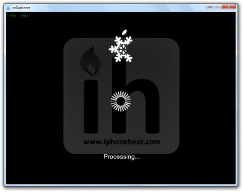

    Run the Sn0wBreeze for iPhone Os 3.1.3 and hit next button.
    sn0wbreeze 313 1sn0wbreeze 313 2

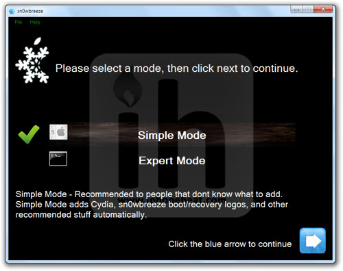

    Step 3
    choose Simple Mode. Click the Next Arrow button.
    sn0wbreeze 313 3

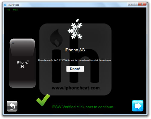

    Step 5
    Sn0wBreeze will verify your selected firmware 3.1.3 file.
    Hit Next.
    sn0wbreeze 313 5sn0wbreeze 313 6

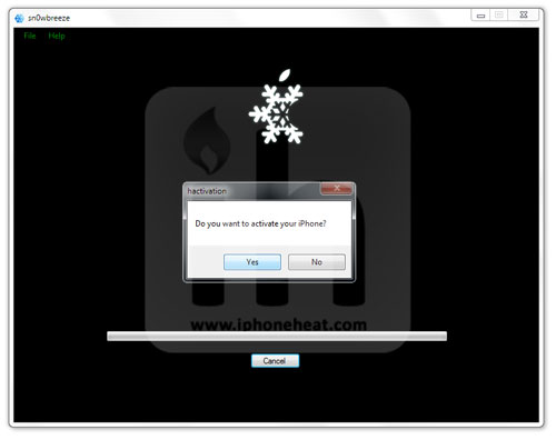

    Step 6
    On the next screen, Sn0wBreeze will ask you: Do you want to activate your iPhone?
    • Hit Yes button for hacktivation (for unofficial carriers)
    • Hit No if you want to use official carrier (AT&T etc).
    sn0wbreeze 313 7

    Hit the Start button. SnowBreeze will start building custom firmware for your iPhone that we will use later to jailbreak iPhone OS 3.1.3.
    sn0wbreeze 313 8

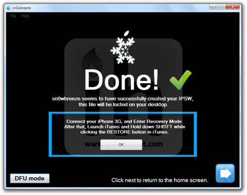

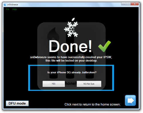

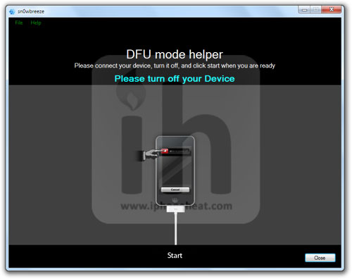

    Step 8
    Once the custom IPSW file building process is complete, Sn0wbreeze will prompt you if your iPhone is already jailbroken or not. Select the right option.
    sn0wbreeze 313 9
    Then Sn0wBreeze will tell if if you need to put your iPhone into recover mode or DFU Mode depending on wether you iPhone ws jailbroken or not. now it’s time to restore your iPhone with that custom firmware that you just built using Sn0wBreeze.
    sn0wbreeze 313 10sn0wbreeze 313 11
