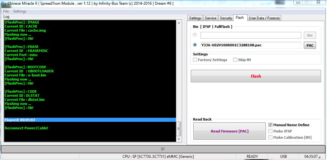

    Thumbs up تجربة ناجحة لتفليش huawei y336 u02 علي الإنفينتي
    كود PHP:
    Card foundS/: , v0129Chinese Miracle II  [SPD modulev 1.12
    Loading
    Y336-U02V100R001C328B108.pacCRVersion  BP_R1.0.0PacCPUinfo SC7731_2341APacVersion Y336-U02V100R001C328B108FastCheck  0x50AF99EC
    Loading files
    File fdl1.binFile fdl2.binFile wnvitem.binFile wcnnvitem.binFile u-boot-spl-16k.binFile wmodem.binFile wdsp.binFile wcnmodem.binFile boot.imgFile recovery.imgFile system.imgFile userdata.imgFile logo.bmpFile logo_1.bmpFile sysinfo.imgFile custommenaf.imgFile prodnv.imgFile cache.imgFile u-boot.binFile dlstat.binFile SC7731_2341A_SB.xml
    Load Ok
    Operation Flash v1.12 ]
    FlashFiles set for flashing : [ MCU ] : Y336-U02V100R001C328B108.pacCRVersion  BP_R1.0.0PacCPUinfo SC7731_2341APacVersion Y336-U02V100R001C328B108File fdl1.binFile fdl2.binFile wnvitem.binFile wcnnvitem.binFile u-boot-spl-16k.binFile wmodem.binFile wdsp.binFile wcnmodem.binFile boot.imgFile recovery.imgFile system.imgFile userdata.imgFile logo.bmpFile logo_1.bmpFile sysinfo.imgFile custommenaf.imgFile prodnv.imgFile cache.imgFile u-boot.binFile dlstat.bin
    1. Remove battery
    Insert battery back2Press and hold 'VolumeUp' and 'VolumeDown' keys3Insert cable
    ====  Wait for phone...
    Phone found! [ 182 ]Port OpenedSync...InitBoot Done 0x81 ] , Ver SPRD3Sync...Sending FDL[Info] : If SW freeze here morethan 15 seconds remove cablePickUp loaders from pacFDL Ready!Boot Ver Spreadtrum Boot Block version 1.1Sending FLASH FDLFLASH FDL Ready!Boot Ok!
    FlashMode Set Ok!PMTManager Load 0x16 recordsPMTManager PMT Update Ok!Flashing now
    [FlashProc] : ERASE Current ID   ERASEUBOOTCurrent Part uboot[FlashProc] : Ok!
    FlashProc] : ERASE Current ID   ERASEDLSTATCurrent Part dlstat[FlashProc] : Ok!
    FlashProc] : ERASE Current ID   ERASEGLOBALINFOCurrent Part globalinfo[FlashProc] : Ok!
    FlashProc] : BOOTCODECurrent ID   SPLLOADERCurrent File u-boot-spl-16k.binFlashing now ... [FlashProc] : Ok!
    FlashProc] : CODE  Current ID MODEM_WCurrent File wmodem.binFlashing now ... [FlashProc] : Ok!
    FlashProc] : CODE  Current ID DSP_WCurrent File wdsp.binFlashing now ... [FlashProc] : Ok!
    FlashProc] : CODE  Current ID BOOTCurrent File boot.imgFlashing now ... [FlashProc] : Ok!
    FlashProc] : CODE  Current ID RECOVERYCurrent File recovery.imgFlashing now ... [FlashProc] : Ok!
    FlashProc] : IMAGECurrent ID SYSTEMCurrent File system.imgFlashing now ... [FlashProc] : Ok!
    FlashProc] : IMAGECurrent ID USERDATACurrent File userdata.imgFlashing now ... [FlashProc] : Ok!
    FlashProc] : CODE  Current ID BOOTLOGOCurrent File logo.bmpFlashing now ... [FlashProc] : Ok!
    FlashProc] : CODE  Current ID FASTBOOT_LOGOCurrent File logo_1.bmpFlashing now ... [FlashProc] : Ok!
    FlashProc] : IMAGECurrent ID SYSINFOCurrent File sysinfo.imgFlashing now ... [FlashProc] : Ok!
    FlashProc] : IMAGECurrent ID CUSTOMCurrent File custommenaf.imgFlashing now ... [FlashProc] : Ok!
    FlashProc] : ERASE Current ID   FLASHCurrent Part wruntimenv1[FlashProc] : Ok!
    FlashProc] : CODE  Current ID PRODNVCurrent File prodnv.imgFlashing now ... [FlashProc] : Ok!
    FlashProc] : IMAGECurrent ID CACHECurrent File cache.imgFlashing now ... [FlashProc] : Ok!
    FlashProc] : ERASE Current ID   ERASEMISCCurrent Part misc[FlashProc] : Ok!
    FlashProc] : BOOTCODECurrent ID   UBOOTLOADERCurrent File u-boot.binFlashing now ... [FlashProc] : Ok!
    FlashProc] : CODE  Current ID DLSTATCurrent File dlstat.binFlashing now ... [FlashProc] : Ok!
    Elapsed00:05:03
    Reconnect Power
    /Cable
