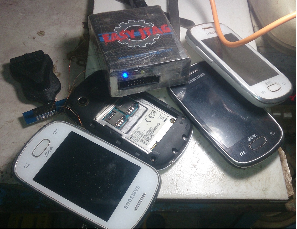

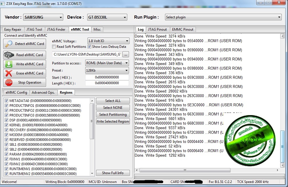

    اليوم بحمد الله تم اصلاح الذكرة الداخلية للاستار S5282
    تم اصلاح الذاكرة الدخلية لـــ S5282 emmc بنجاح
    كود:
    CMD Pullup Level:1866 mV
    CMD Active Level:2103 mV
    eMMC Device Information
    EMMC CID : 15010053355530304D026B077265603E
    EMMC CSD : D02701320F5903FFF6DBFFE18E404028
    EMMC Manufacturer ID: 0015 , OEM ID: 0100
    EMMC Date: 06/2013 Rev.0x2
    EMMC NAME: S5U00M , S/N: 1795650149
    EMMC ROM1 (Main User Data) Capacity: 3728 MB
    EMMC ROM2 (Boot Partition 1) Capacity: 2048 kB
    EMMC ROM3 (Boot Partition 2) Capacity: 2048 kB
    EMMC RPMB (Replay Protected Memory Block) Capacity: 128 kB
    Extended CSD rev 1.5 (MMC 4.41)
    Boot configuration [PARTITION_CONFIG: 0x08] Boot from:ROM2 (Boot Partition 1)
    Boot bus config [177]: 0x00 , width 1bit , Partition config [179]: 0x08.
    Backup saved: S5U00M_1795650149_20150002_1133.extcsd
    Done.
    Checking NAND Image : C:\Users\LYON-GSM\Desktop\SAMSUNG_GT-S5282_dump_rom1_rom2_extcsd\EMMC_ROM1_00000000_40000000.bin
    Data partitions (firmware parts) count is 128 (dec)
    **** partitions (partitions storing partition table) count is 1 (dec)
    Block size is 200
    File successefuly loaded!
    Processing file...C:\Users\LYON-GSM\Desktop\SAMSUNG_GT-S5282_dump_rom1_rom2_extcsd\EMMC_ROM1_00000000_40000000.bin
    Adding write JOBarrow 10x10: 00000000_00E00000
    Adding write JOBarrow 10x10: 00E00000_003C0000
    Adding write JOB: 011C0000_003C0000
    Adding write JOB: 01580000_00500000
    Adding write JOB: 01A80000_00500000
    Adding write JOB: 01F80000_00A00000
    Adding write JOB: 02980000_00A00000
    Adding write JOB: 03380000_00A00000
    Adding write JOB: 03D80000_00080000
    Adding write JOB: 03E00000_00200000
    Adding write JOB: 04000000_00200000
    Adding write JOB: 04200000_00800000
    Adding write JOB: 04A00000_003C0000
    Adding write JOB: 04DC0000_003C0000
    Adding write JOB: 05180000_003C0000
    Adding write JOB: 05540000_003C0000
    Adding write JOB: 05900000_00040000
    Adding write JOB: 05940000_00040000
    Adding write JOB: 05980000_00040000
    Adding write JOB: 059C0000_00A00000
    Adding write JOB: 063C0000_20000000
    Adding write JOB: 263C0000_38000000
    Adding write JOB: 5E3C0000_08000000
    Adding write JOB: 663C0000_00500000
    Adding write JOB: 668C0000_00A00000
    Adding write JOB: 672C0000_81800000
    Adding write JOB: 00004400_00002000
    Adding write JOB: 00006400_00100000
    Writing 000040000000 bytes to 00000000 ...ROM1 (USER ROM)
    Done. Write Speed: 12888 kB/s
    Writing 000040000000 bytes to 00E00000 ...ROM1 (USER ROM)
    Done. Write Speed: 4754 kB/s
    Writing 000040000000 bytes to 011C0000 ...ROM1 (USER ROM)
    Writing 000040000000 bytes to 01580000 ...ROM1 (USER ROM)
    Done. Write Speed: 6110 kB/s
    Writing 000040000000 bytes to 01A80000 ...ROM1 (USER ROM)
    Done. Write Speed: 3326 kB/s
    Writing 000040000000 bytes to 01F80000 ...ROM1 (USER ROM)
    Done. Write Speed: 1105 kB/s
    Writing 000040000000 bytes to 02980000 ...ROM1 (USER ROM)
    Done. Write Speed: 1024 kB/s
    Writing 000040000000 bytes to 03380000 ...ROM1 (USER ROM)
    Done. Write Speed: 855 kB/s
    Writing 000040000000 bytes to 03D80000 ...ROM1 (USER ROM)
    Done. Write Speed: 685 kB/s
    Writing 000040000000 bytes to 03E00000 ...ROM1 (USER ROM)
    Done. Write Speed: 1562 kB/s
    Writing 000040000000 bytes to 04000000 ...ROM1 (USER ROM)
    Done. Write Speed: 2634 kB/s
    Writing 000040000000 bytes to 04200000 ...ROM1 (USER ROM)
    Done. Write Speed: 6558 kB/s
    Writing 000040000000 bytes to 04A00000 ...ROM1 (USER ROM)
    Done. Write Speed: 4000 kB/s
    Writing 000040000000 bytes to 04DC0000 ...ROM1 (USER ROM)
    Done. Write Speed: 3940 kB/s
    Writing 000040000000 bytes to 05180000 ...ROM1 (USER ROM)
    Done. Write Speed: 3274 kB/s
    Writing 000040000000 bytes to 05540000 ...ROM1 (USER ROM)
    Writing 000040000000 bytes to 05900000 ...ROM1 (USER ROM)
    Done. Write Speed: 343 kB/s
    Writing 000040000000 bytes to 05940000 ...ROM1 (USER ROM)
    Done. Write Speed: 349 kB/s
    Writing 000040000000 bytes to 05980000 ...ROM1 (USER ROM)
    Done. Write Speed: 336 kB/s
    Writing 000040000000 bytes to 059C0000 ...ROM1 (USER ROM)
    Done. Write Speed: 2615 kB/s
    Writing 000040000000 bytes to 063C0000 ...ROM1 (USER ROM)
    Done. Write Speed: 28002 kB/s
    Writing 000040000000 bytes to 263C0000 ...ROM1 (USER ROM)
    Done. Write Speed: 916 kB/s
    Writing 000040000000 bytes to 5E3C0000 ...ROM1 (USER ROM)
    Done. Write Speed: 24301 kB/s
    Writing 000040000000 bytes to 663C0000 ...ROM1 (USER ROM)
    Done. Write Speed: 5601 kB/s
    Writing 000040000000 bytes to 668C0000 ...ROM1 (USER ROM)
    Done. Write Speed: 9337 kB/s
    Writing 000040000000 bytes to 672C0000 ...ROM1 (USER ROM)
    Done. Write Speed: 27421 kB/s
    Writing 000040000000 bytes to 00004400 ...ROM1 (USER ROM)
    Done. Write Speed: 52 kB/s
    Writing 000040000000 bytes to 00006400 ...ROM1 (USER ROM)
    Done. Write Speed: 1292 kB/s

    على فكره الدامب من يوم 24/1
    وانا احول في التصليح
    والجهاز الا قمت باصلاح بيقلاع الشاشة البدائية ومايكمل
    وسويت اريز وقمت بكتابة الملف من دون مشاكل
    اسما ياض يا حسام عندي ثاني 4 اجهزة
    تعالى وساعدني
    شوف
