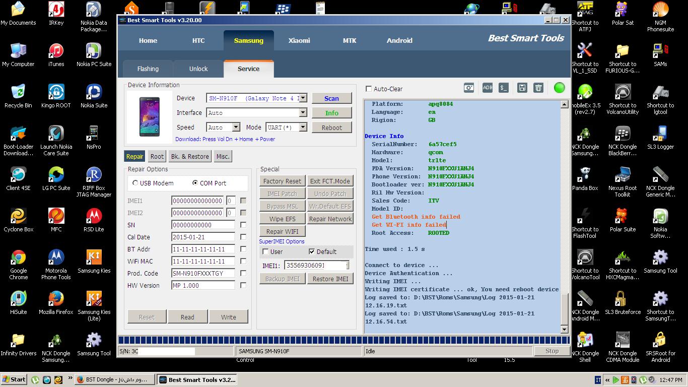

    افتراضي ***Samsung Note4 _ SM-N910F***first in the world UNLOCK +repair IM OK
    Fw.Ver : BstKey V3.20
    Serial : 3C1A----------------------------------
    Active User:-=MR_Gsm=-.
    PL2303 : 2.0.2.1 2005-07-25
    Best Smart Tools, Load OK.
    Download: Press Vol Dn + Home + Power
    UART Cable Resistor: 523 K
    ReadCodes/Unlock/Repair:
    1. Type *#0808# and set USB to AP.
    2. Set "USB Settings" to "DM+MODEM+ADB".
    3. Click "OK".
    Cables: MicroUSB
    Interface: Auto, Change UART when request
    Read Info/Flashing/UserLock/Backup:
    Cables: MicroUSB
    Interface: Auto
    Load PDA "D:\BST\Roms\Samsung\SM-N910F_BST_Unlock-IMEI_Patch.tar" ok
    Restarting ADB service ... ok
    Scanning devices ... 2 found
    dev[1]
    Manufactory: SAMSUNG
    Model: SM-N910F
    Hardware: QCOM
    Mode: normal
    dev[2]
    Model:
    Hardware:
    Mode: QCDI,MTP
    Selected dev[1] SAMSUNG SM-N910F
    Checking environment ...
    System Info
    Display ID: KTU84P
    System Ver: 4.4.4 REL
    API Level: 19
    Incremental: N910FXXU1ANJ4
    Model: SM-N910F
    Brand: samsung
    Device: trlte
    Platform: apq8084
    Language: en
    Rigion: GB
    Device Info
    SerialNumber: 6a57cef5
    Hardware: qcom
    Model: trlte
    PDA Version: N910FXXU1ANJ4
    Phone Version: N910FXXU1ANJ4
    Bootloader ver: N910FXXU1ANJ4
    Ril Hw Version: MP 0.900
    Sales Code: ITV
    Model ID:
    Get Bluetooth info failed
    Get WI-FI info failed
    Network [1]: GSM IMEI: 354201065++++++++++++
    Root Access: ROOTED
    Time used : 1.6 s
    Reboot device to DOWNLOAD mode ...
    Re-scan device before any operation please
    Scanning devices ... 0 found
    Scanning devices ... 1 found
    dev[1]
    Manufactory:
    Model:
    Hardware:
    Mode: DOWNLOAD
    Connect to device ...
    Device pit saved to D:\BST\backup\samsung\pit\SM-N910F\SM-N910F_2015-01-21_11.48.11.pit
    Write file cache.img.ext4 ...
    Write file recovery.img ...
    Flash completed
    Time used : 8.4 s
    dev[1]
    Model: SM-N910F
    Hardware: QCOM
    Mode: normal
    dev[2]
    Model:
    Hardware:
    Mode: QCDI,MTP
    System Info
    Display ID: KTU84P
    API Level: 19
    Model: SM-N910F
    Brand: samsung
    Device: trlte
    Platform: apq8084
    Language: en
    Rigion: GB
    Device Info
    Hardware: qcom
    Model: trlte
    Sales Code: ITV
    Model ID:
    Network [1]: GSM IMEI: 35420106++++++++++++++++++++++++++
    Root Access: ROOTED
    Time used : 1.5 s
    Prepare environment ...
    Backup EFS ... D:\BST\backup\samsung\efs\SM-N910F\EFS_samsung_SM-N910F_35420106-----------------8_2015-01-21_11.49.47.zip ok
    Wiping EFS ... ok
    Reboot device to NORMAL mode ...
    Time used : 35.7 s
    dev[1]
    Model: SM-N910F
    Hardware: QCOM
    Mode: normal
    dev[2]
    Model:
    Hardware:
    Mode: MTP
    System Info
    Display ID: KTU84P
    API Level: 19
    Model: SM-N910F
    Brand: samsung
    Device: trlte
    Platform: apq8084
    Language: en
    Rigion: GB
    Device Info
    Hardware: qcom
    Model: trlte
    Ril Hw Version:
    Sales Code: ITV
    Model ID:
    Root Access: ROOTED
    Time used : 1.5 s
    Device Authentication ...
    Writing IMEI ...
    Writing IMEI certificate ... ok, You need reboot device
    Log saved to: D:\BST\Roms\Samsung\Log 2015-01-21 12.16.19.txt
    Thanks BST Dongle
