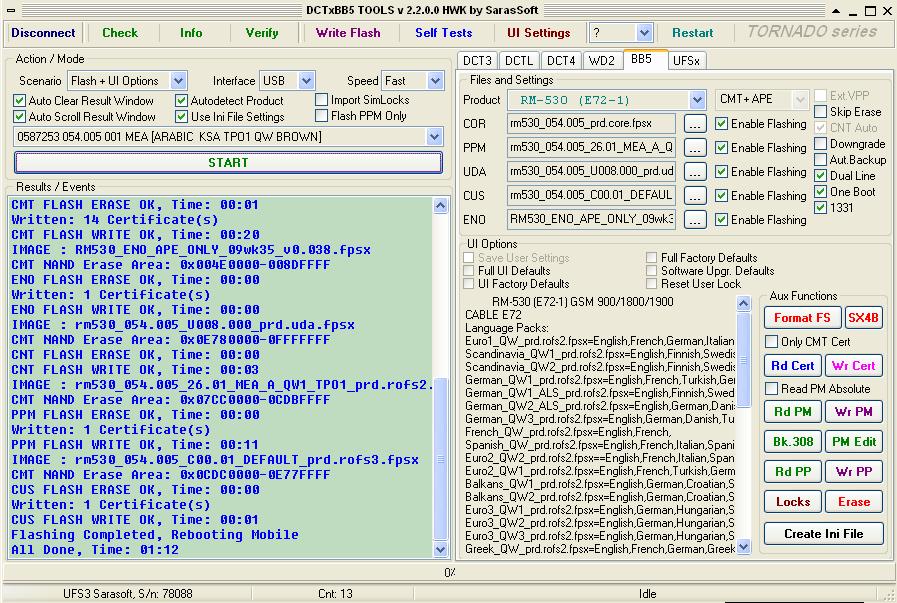

    تفليش C1-01 RM-607 بنجاح
    Insert USB Cable to Switched OFF Phone and Power ON
    IF_USB: XGOLD213
    IF_SBL: XGOLD213, Ok
    IF_EBL: Quantum_Bootloader_2.3_M1S1.2.3, Mode: CC
    FL_ID : EC000024, Samsung Unknown 512Mb
    MCU FLASH BUNDLE: rm607__04.40.mcusw
    Flash File: rm607__04.40.mcusw_ebl_psi.fls
    Erase Area: 0x40000000 - 0x4001FFFE, Erased: 00:00
    Write Area: 0x40000000 - 0x4001FFFE, Written: 00:00
    Erase Area: 0x40040000 - 0x4007FFFE, Erased: 00:00
    Write Area: 0x40040000 - 0x4007FFFE, Written: 00:00
    Erase Area: 0x40080000 - 0x4009FFFE, Erased: 00:00
    Write Area: 0x40080000 - 0x4009FFFE, Written: 00:00
    Erase Area: 0x400A0000 - 0x4019FFFE, Erased: 00:03
    Write Area: 0x400A0000 - 0x4019FFFE, Written: 00:02
    Erase Area: 0x40400000 - 0x41BFFFFE, Erased: 01:34
    Write Area: 0x40400000 - 0x41B7FFFE, Written: 00:58
    PPM FLASH BUNDLE: rm607__04.40.ppm_m_a
    Flash File: package_m_a.ppm_ebl_psi.fls
    Erase Area: 0x41C00000 - 0x421FFFFE, Erased: 00:13
    Write Area: 0x41C00000 - 0x41F263AE, Written: 00:08
    CNT FLASH BUNDLE: rm607__04.40.image_m_a_059B105
    Flash File: package_m_a_059B105.image.fls
    Erase Area: 0x42200000 - 0x43E5FFFE, Erased: 00:19
    Write Area: 0x42200000 - 0x42D5FFFE, Written: 00:25
    Erase Area: 0x43E60000 - 0x43F3FFFE, Erased: 00:03
    Flashing Done: 03:56
    ShutDown Done

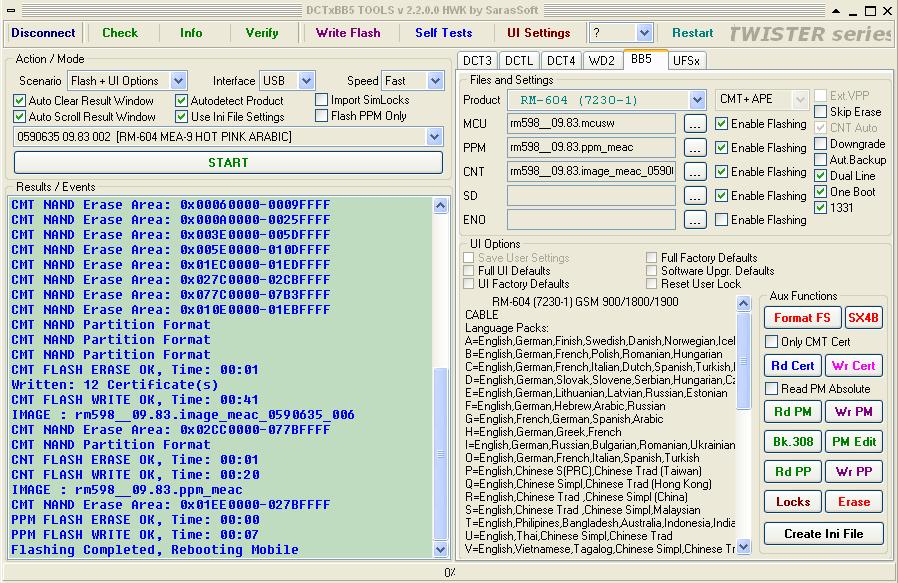

    تفليش 7230 rm-604
    الموضوع المخصص بتجارب الاعضاء فى تفليش الاجهزة { BB5} الحديثة USB على التورنيدو
    كود:
    Insert USB Cable to Switched OFF Phone and Power ON USB BOOT : 60,07 [Rm-604] [2.2.0.0] CMT ASICID: 000000010000022600000001020C192102044100 EM 1 ID : 00001040 EM 2 ID : 00001030 CMT PUBID : 27900109FE2E0049B6E45A953E0925628CA7947A CMT MODE : 00 CMT HASH : 7B045400E1752022F9EB80B0DEA9C65D CMT ROMID : 67E82268F29CEA60 CMT 2ND Bt: RAP3Gv40_2nd.fg, Ver: 11.16.0 CMT 2ND Bt: SILO OK CMT RMID0 : 00000000-00000000 CMT MCID0 : FFFF0000-00000000 CMT FLID0 : 00980030-00000131, Tos OneNAND-1G CMT RQALG : XSR 1.6 CMT 2ND Boot OK CMT ALGO : RAP3Gv40_XSR17_alg.fg, Ver: 11.16.0 CMT KSIG0 : 4431C834027BBA0D18A5ED745CAFA04BA679A74A CMT ALG Boot OK IMAGE : rm598__09.83.mcusw CMT NAND Erase Area: 0x00020000-000203FF CMT NAND Erase Area: 0x00060000-0009FFFF CMT NAND Erase Area: 0x000A0000-0025FFFF CMT NAND Erase Area: 0x003E0000-005DFFFF CMT NAND Erase Area: 0x005E0000-010DFFFF CMT NAND Erase Area: 0x01EC0000-01EDFFFF CMT NAND Erase Area: 0x027C0000-02CBFFFF CMT NAND Erase Area: 0x077C0000-07B3FFFF CMT NAND Erase Area: 0x010E0000-01EBFFFF CMT NAND Partition Format CMT NAND Partition Format CMT NAND Partition Format CMT FLASH ERASE OK, Time: 00:01 Written: 12 Certificate(s) CMT FLASH WRITE OK, Time: 00:41 IMAGE : rm598__09.83.image_meac_0590635_006 CMT NAND Erase Area: 0x02CC0000-077BFFFF CMT NAND Partition Format CNT FLASH ERASE OK, Time: 00:01 CNT FLASH WRITE OK, Time: 00:20 IMAGE : rm598__09.83.ppm_meac CMT NAND Erase Area: 0x01EE0000-027BFFFF PPM FLASH ERASE OK, Time: 00:00 PPM FLASH WRITE OK, Time: 00:07 Flashing Completed, Rebooting Mobile

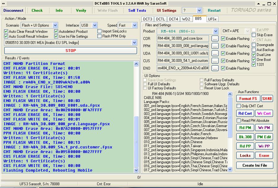

    تفليش n86 على usb

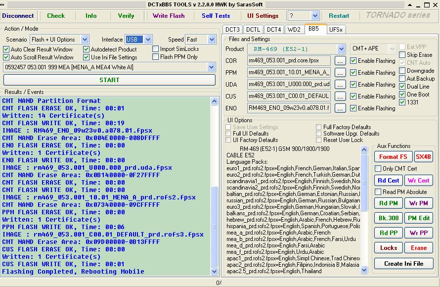

    e52 بنجاح
